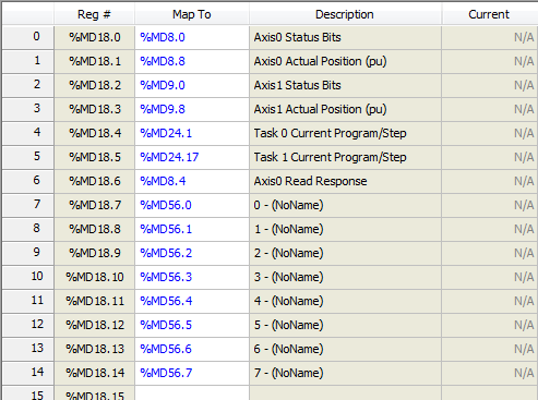

Example
Requirements
First, the user lists the desired registers to read from the RMC75:
Axis 0 Status Bits
Axis 0 Actual Position
Axis 1 Status Bits
Axis 1 Actual Position
Task 0 Current Step
Task 1 Current Step
The first 8 registers of the Variable Table.
In addition, the user would like to read some other registers occasionally.
Implementation
First, PROFIBUS communications requires that Axis 0 Status Bits register must be in the first Response Block register, which is entry 0 in the Indirect Data Map.
Second, the Read Response register is needed in order to read other registers occasionally.
Third, the user determines which registers must be in registers 0-7 to preserve consistency. The rest of the registers can then be placed in the remaining registers.
The user chose to set up the Indirect Data Map like this:

In step 33, bit 31 of the Command Register changed, which then issued the move command.
Debugging Data Channel 0
The Event Log displays the Data Channel 0 data in the following order:
Read/Write Register (register 6), Explicit Write Value (register 7)
Assume a value of 46.2 was written to %MD56.0 via PROFIBUS. The Event Log may look like this:
Step 38 shows that the File is 56 (38 in hexadecimal), bit 31 is set to 1 for a write. The Explicit Write register contains the write value 46.2, but it is very difficult to decipher a float value from its hexadecimal representation.
Step 39 shows that the Read/Writer Request bit changed, which requested the write.
