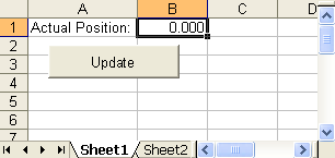

This sample will use Microsoft Excel 2010 to set up a button to read the Actual Position of an RMC70 located at IP address "192.168.0.22". The Actual Position will be displayed in a cell in the spreadsheet and be updated each time the Update button is clicked. The project developed in this walk-through is included as a Microsoft Excel file in the RMCLink example projects.
The final application will look like this:

On the Developer tab, click Design Mode.
On the Developer tab, click Insert and select the Command Button (Active X) control.
Drag to create a button in the location and of the size shown above.
Right-click the button and choose Properties.
Change the (Name) property to "updateButton".
Change the Caption property to "Update".
Close the Properties window.
Double-click on the Update button you have just created. This should re-open the Microsoft Visual Studio window an empty click handler subroutine for this button. Enter the text below for the body of this subroutine. Change the IP address to the IP address of your controller.
updateButton_Click Handler |
Private Sub updateButton_Click() On Error GoTo HandleError Dim srv As New RMCLinkServer Dim rmc As RMCLink Set rmc = srv.CreateEthernetLink(dtRMC70, "192.168.0.22") ' Connect to the controller. rmc.Connect ' Read the Actual Position from Axis 0 of the RMC70. Dim data As Variant data = rmc.ReadFFile(fn70StatusAxis0, 8, 1) ' Copy the Actual Position we read into cell 'B1'. Cells(1, 2) = data(0) ' Disconnect from the controller. rmc.Disconnect Exit Sub HandleError: MsgBox "Communication Error #" & Err.Number & ": " & Err.Description End Sub |
On the Run menu, click Exit Design Mode.
Close the Microsoft Visual Basic window.
You should now be able to click our custom Update button to automatically read the current Actual Position and display it in cell B1.
