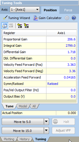

Use the Tuning Tools to tune the axes. The Tuning Tools pane streamlines the tuning process by providing the following:
Overview
The Tuning Tools pane contains all the tools you need to tune an axis:
Axis
Choose the axis to tune, and choose position or pressure or force.
Click Tuning Wizard to start Autotuning or to tune from an existing plot.
Click Gain Calculator to choose gains using the slider bar.
Tuning Parameters
You can change the tuning parameters and then download them to the controller by clicking the Download button. For challenging tuning systems, you also have access to all the axis parameters, just as in the Axes Parameters pane in the Axis Tools.
Status Registers
This section provides you with basic axis information. For example, the Actual Position is helpful so you know which direction to move the axis.
You can choose which registers appear by clicking the Customize Tuning Tools button.

Tuning involves repeatedly issuing the same commands to move the axis back and forth. The command buttons ([Click to Set up]) simplify this process. Click the button to customize it.

1. Set Up the Command Buttons
For position axes, click the
Position tab. For pressure or force axes, click the Pressure or Force tab. Then, set up the command buttons so that one button will move the axis one direction, and the other will move it in the other direction.
  1. Click the down arrow on the command button .
  2. Enter the parameters for the command, then click OK.
  3. Make sure the correct plot template is selected.
    Tip:
    For a typical hydraulic cylinder position axis, the Accel and Decel parameters of the Move absolute command are typically on the order of 10 to 100pu/sec2. The speed is typically between 1 and 30pu/sec.
    Examples:
  4. Repeat the previous step for the other command button. For position axes, make sure to enter the same velocity, acceleration, and deceleration, but a different position. For pressure/force axes, use the same ramp time, but a different pressure/force value.
  5. Click OK. Now you will see that the command buttons are labeled.
