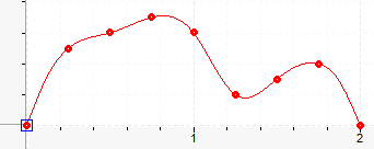

+0 Zero-Velocity Endpoints
The endpoints will have zero velocity and acceleration. This is the most commonly-used option. Curves with zero-velocity endpoints can be repeated cyclically.

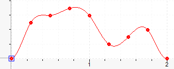

+1 Natural-Velocity Endpoints
The endpoints will have their velocity automatically selected to match the natural slope of the curve at the endpoints. The acceleration at the endpoints will be zero. Curves with natural-velocity endpoints cannot be repeated cyclically because the endpoint velocities are typically not equal.

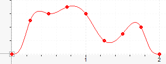

+2 Cyclic Curve
The endpoints are assumed to wrap. Therefore the acceleration, velocity, and position will be continuous between cycles of this curve, although the velocity and acceleration at each endpoint will not necessarily be zero.
If the y-values of the first and last points are not equal, and the curve is run for more than 1 consecutive cycle, the curve will be automatically offset so that the first point of the next cycle matches the last point of the previous cycle.
For Advanced format curves, if an endpoint is defined as a Fixed Velocity type, it will use that velocity even if the curve is cyclic. Setting each endpoint to a different fixed velocity will cause a discontinuity in the velocity between cycles of the curve, but the curve can still be used cyclically.

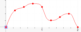

Overshoot Protection
The Overshoot Protection option prevents the curve from exceeding a local maximum or local minimum point. A local maximum occurs where a point is greater than or equal to both the preceding point and the following point. A local minimum occurs where a point is less than or equal to both the preceding point and the following point. Overshoot protection will not prevent overshooting in other locations.
When overshoot protection is enabled, the velocity is set to zero at each local minimum/maximum point, which eliminates the chance of the curve overshooting that point for the curve segments on either side of the point.
For Advanced format curves, Overshoot Protection will not apply to Fixed-Velocity points, or points at the beginning or end of a Constant-Velocity segment.
Example 1
Consider the cubic curve data in the Endpoint Behavior section above. Without Overshoot Protection enabled, the curve looks like this:
Notice that the curve overshoots the points after times 0.75, 1.25, and before 1.75.
With overshoot protection enabled, the curve will look like this:
Notice that the curve no longer overshoots the points after times 0.75, 1.25, and before 1.75. Notice, however, that the curve still overshoots between points 0.25 and 0.5 because neither point is a local minimum or maximum.
