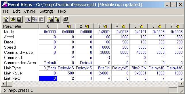

Set Up the Event Step Table
Setting up and tuning position/pressure control requires issuing multiple commands numerous times. Doing this from a PLC or by typing commands in RMCWin is very awkward. To simplify the process, Event Steps in RMCWin should be used for setting up and tuning position/pressure control.
To perform position/pressure control, the following steps must be set up in the Event Step Table:
Issue a P command so the axis will hold position.
Issue a Set Null Drive to Integral Drive (n) command. This updates the null drive (drive needed to hold position), which is critical for pressure control.
Move the axis to the correct starting position. Normally, the axis should be at a position where the pressure is below the desired entry pressure (Pressure Set A).
Set up the pressure control mode. This sets up the parameters that the pressure axis will use when it enters pressure regulating mode. This is done by issuing the Set Pressure (^) command.
Note: this step does not put the axis into pressure regulating mode.
This step sets up the following parameters:
Mode: |
Sets Ramp Type, Ramp Time and Integrator Mode |
Pressure at which Pressure control begins. |
Pressure at which Pressure control ends. |
Time to ramp to commanded pressure. |
Command Pressure: |
The pressure the system will go to when regulating pressure. |
Move in the direction of increasing pressure with the monitor pressure bit set (pressure monitoring mode). When the pressure reaches Pressure Set A, the axis enters pressure regulating mode. The axis enters pressure control according to the parameters previously set up by the Set Pressure command.
Control the pressure as desired.
The following sample Event Step Table illustrates these steps:
Explanation of each step in the Event Step table:
Step 0:
This step is normally linked to after finishing a sequence. If the event control is at step 0, it usually means the event control has stopped. This step does nothing.
Step 1:
Issues a P command so the axis will hold position. Waits for 1/2 sec so the drive output will stabilize for the next step.
Step 2:
Issues a Set Null Drive to Integral Drive. This updates the null drive (drive needed to hold position), which is critical for pressure control.
Step 3:
This step moves to 36.0 in. at 10 in./sec (assuming it is set up for a resolution of 0.001 in., then 36000 = 36 in. and 10000 = 10 in.) It then waits until bit 1 (the In Position bit) is on before continuing to the next step.
Step 4:
This step sets up the pressure parameters that will be used in step 5. The Mode word is set up to Calculate Ramp Time and Integrator Active Only at Pressure. Pressure Set A is 1000, Pressure Set B is 500, and the Command Pressure is 5000. This step waits 0 msec and goes to step 5. Note that the Ramp Time, set to 200, is not used since Calculate Ramp Time has been selected.
Step 5:
This step moves toward 40 in. with the Monitor Pressure bit set in the Mode word. Once the pressure reaches Pressure Set A (as set in step 4), it will begin controlling pressure. It will go to a pressure of 5000 ( as set in step 4). This step waits until bit 0 (At Pressure) is on before continuing to step 6.
Step 6:
This step changes the Command Pressure to 6000, with the same Pressure Set A and B as in step 4 and a Ramp Time of 50. The pressure will ramp to 6000, and then the step waits 1000 msec before continuing to step 7.
Step 7:
This step changes the Command Pressure to 5000, with the same Pressure Set A and B and Ramp Time values as in step 6. The pressure will ramp to 5000, and then the step waits for 1000 msec before continuing to step 5. Steps 5 and 6 will repeat until a Quit Events (Q) command is issued. Ramping the pressure up and down in this manner is very useful when tuning the pressure. It is important that the Ramp Time be fairly short, because parameters suitable for slow changes (long Ramp Times) may make the system unstable for fast changes.
