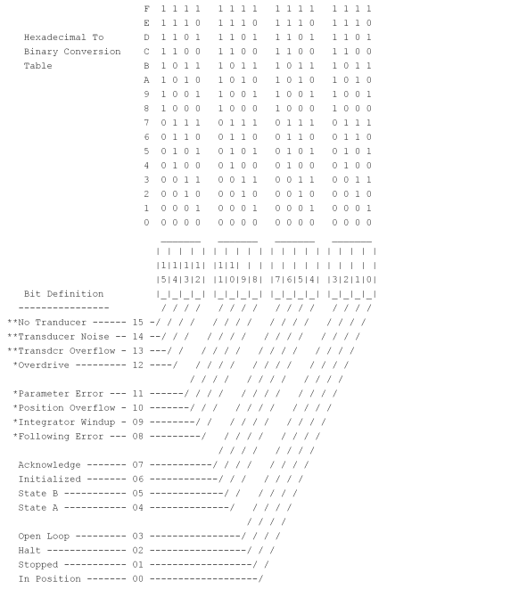

The axis Status word contains 16 bits of information about the status of the axis. The hexadecimal table below provides an easy way to convert hexadecimal numbers to bit patterns.
* Can cause a Soft or Hard Stop if the corresponding bits are set in the Auto Stop field.
** Will cause either a Soft or Hard Stop depending how Auto Stop bits 5, 6, and 7 are set.
