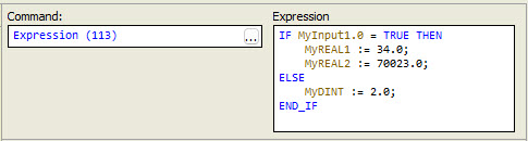

Example 2
IF MyInput1 = TrueTHEN
MyREAL1 := 34.0;
MyREAL2 := 70023.0;
ELSE
MyDINT := 2;
END_IF

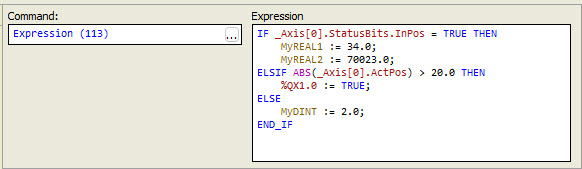

Example 3
IF_Axis[0].StatusBits.InPos = TrueTHEN
MyREAL1 := 34.0;
MyREAL2 := 70023.0;
ELSIFABS(_Axis[0].ActPos) > 20.0 THEN
%QX0.1 := True;
ELSE
MyDINT := 2;
END_IF
