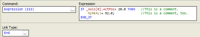

Example 1
IF _Axis[0].ActPos> 20.0 THEN    //This is a comment.
MyREAL:= 92;                        //This is a comment, too.
END_IF

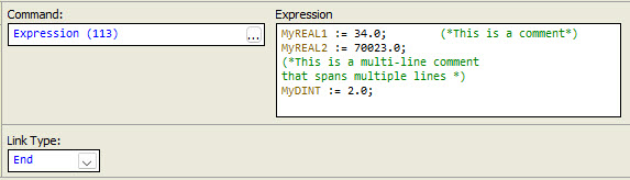

Example 2
MyREAL1 := 34.0;          (*This is a comment*)
MyREAL2 := 70023.0;
(*This is a multi-line comment
that spans multiple lines *)
MyDINT := 2;
