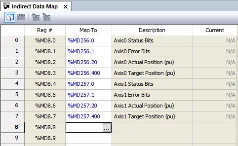

The user would like to put some of the RMC registers in the Indirect Data Map so that it will speed up the communications. The user decides to put the following registers in the Indirect Data Map:

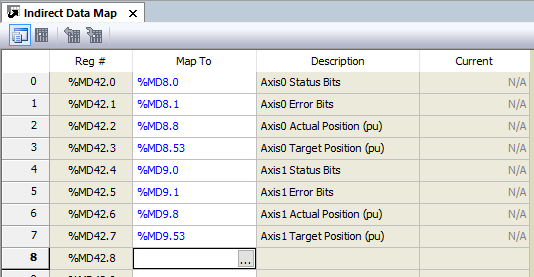

The user then sets up the Indirect Data Map like this:
Now, instead of reading eight registers in various locations, the user can read them in one block of eight registers beginning at %MD42.0, as shown in the leftmost column of the Indirect Data Map Editor above.
Once the Indirect Data Map has been set up in RMCTools and downloaded to the RMC150, you can read and write to the RMC150 Indirect Data registers %MD42.0 to %MD42.255. The reads and writes will be as if done to each mapped register.
